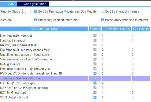

Note I disable the interrupts with priority >= 1.
Interrupt priority listing is available at the bottom of the page.

Here is the listing of the NVIC:

1) One of my possible theories for this issue is that maybe I am disabling an interrupt that is required for the flash erase, do you think this could be possible? I have read the reference manual but I could not find something like this.

(1) No there's no such interrupt. Ensure that systick interrupt does not occur (or relocate the vectors to RAM along with systick handler)

(1) I had already moved the NVIC to ram (ITCM) via the following code. The systick interrupt still causes an error if I do not disable interrupts.
#define VECTOR_SIZE 166
uint32_t vectorTable[VECTOR_SIZE] __attribute__ ((aligned(512), section(".INST_RAM")));
int main(void)
memcpy(vectorTable, (uint32_t*)0x08000000, sizeof(uint32_t) * VECTOR_SIZE);
SCB->VTOR = (uint32_t)vectorTable;(2) All the ram functions go into ITCM ram via the following code

__set_BASEPRI(0001 << __NVIC_PRIO_BITS);
// Erase app
erase_flash();
// Invalidate data cache
// SCB_InvalidateDCache();
// Enable interrupts
__set_BASEPRI(0);I will go ahead and add SCB_InvalidateDCache_by_Addr() as well and verify.
Any ideas as to what could have been the root cause?
2022-02-26 2:11 PM
1) Well, you've moved the table, but the handlers still are in the flash? or they are in .RamFunc?
More likely than not they are in flash. How can I move them to Ram? Would adding the .RamFunc directive be sufficient?
2) By the way alignment of vector table must be 1024.
Do you have a source for this? I've been using 512 for the last little while.
3) The cache is disabled after reset, simply do not enable it.
I have added the following after main(). It always hard faults with this.
__disable_irq();
SCB_DisableDCache();
__enable_irq();4) Check that there's no write protected sectors.
Confirmed no RDP or WRP. I do want to add those in soon. Apart from disabling WRP are there any other considerations?
2022-02-26 2:56 PM
Well like I said, SCB_InvalidateDCache() is a bit indiscriminate, damaging the stack content is a quick way to get Hard Faults and unpredictable behaviour.
