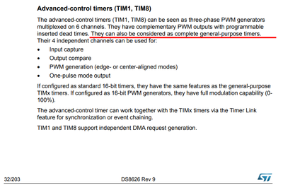

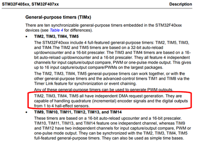

@Vidicon wrote:Mostly yes,
but it does not mention encoder mode for the Advanced-control timers TIM1, TIM8.
AN4013 suggests that 'Advanced' Timers can do everything that 'General-Purpose' Timers can do, and it says that includes the Encoder mode.
But, indeed, the Datasheet says that only some 'General-Purpose' Timers (TIM2-5) have the Encoder mode:
and the description of 'Advanced' timers is unhelpful:
Another 'Documentation Clarification' request for @STOne-32 and @Imen.D
