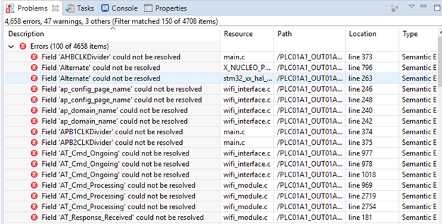

2018-05-08 6:31 AM
Here is revision data for the IDE:
This is the directory I opened in the IDE:
C:\plc\ac6Test3\STM32CubeFunctionPack_PLCWIFI1_V1.0.0\Projects\Multi\Applications\FP_IND_PLCWIFI1\SW4STM32\STM32F401RE-Nucleo
I then did ''Build All'' and had errors in all projects:
Here's a sample of the errors:
And from the ''Console'' window:
make: *** No rule to make target 'C:/Users/massimo oteri/Develop/X-Core-PLC01A1/Functional_Pack/STM32CubeFunctionPack_PLCWIFI1_V1.0.0/Middlewares/ST/STM32_LADDER_LIBRARY/Ladder_Lib.c', needed by 'Middlewares/STM32_LADDER_LIBRARY/Ladder_Lib.o'. Stop.
Thanks,
Dave
2018-05-08 9:30 AM
Hi Dave,
here the problem seems to be related to the relative path of sources within the project tree in Eclipse. You should update your project by replacing the current links to sources with the ones in your working path.
Hope that helps.
Kind regards
Andrea
