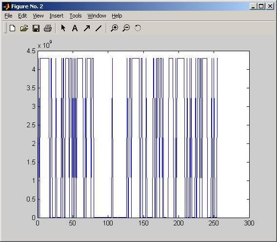

I'm trying to calculate FFT of this signal (using Keil uVision and STM32F103VB:
but the result looks like this:
Here's the code:

data is a float array containing the sine signal. Pictures above shows x and y arrays.
Could anyone tell me what I'm doing wrong?

You haven't given us much to work with here.
From looking at your first plot, a sine wave with values 50 to 250, it would appear your input data might possibly be a series of int's. However you state: ''data is a float array'' Is it really? Your code casts the input data to int's: real[i]=(uint16_t)(data[i]); (I'm assuming data[i] is the input data) If your input data is incorrectly declared as floats, that would be a problem. What is the function prototype for: cr4_fft_256_stm32(y, x, N); ? What are your definitions for y and x?We’re moving the ST Community to a new platform to give you a better and more reliable community experience.
