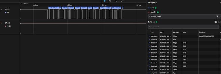

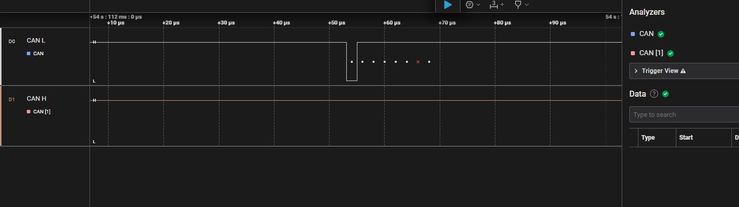

For several days I have been trying to send and receive something via CAN, but I am unable to do so on the Riverdi LCD board. I read two posts here with similar problems and instructions and videos from ST, but it did not solve my problem. CAN still does not work in normal mode. I tried too on loopback mode
STM board: >> Riverdi board
On the second board with nucleo 64, I made a simple program that sends 8 bytes and works correctly.
But riverdi board send like this
Now FDCAN set is to 40Mhz and this is code fdcan.c:

I cant send or recived data. When canfilterconfig.FilterID1 = 0x100; and i send data from secound board riverdi lcd frozen and i can only reset board. But when i change to other ID like 0x101 no frozen. Callback Can is never performed
2024-07-05 2:06 AM
I see in your code this commented line:
//hfdcan1.Init.Mode = FDCAN_MODE_EXTERNAL_LOOPBACK; //I try too
What was the result?
How did you connect the Board to the CAN bus? is there another node connected on the bus? if not for sure it will never work as the acknowledgement mechanism needs that the recipients acknowledge the frame.
