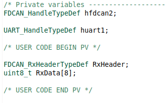

This is not related to CAN but to CubeIDE. Did you declare RxData global?
2024-11-04 9:25 PM
Hi Expert,
Yes RxData is declared globally.
I have shared the sample code we used for Rx and Tx.

I double checked your Rx project and you didn't activate the Rx interrupt, that's why you can't see RxData in Live watch.
I also modified the filter configs. This is the live Expression on Rx side running on two G491 NUCLEO boards. As you can see, the data are updated continuously with the sent data from Tx project.
I'm attaching the reworked Rx project.
