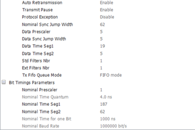

2024-10-18 1:21 AM - edited 2024-10-18 1:23 AM
Do not have any idea about configuring seg 1 and seg 2. Please can you provide brief information?
I am not sending message to any other node right now. Will be verifying the data using Logic Analyzer for successful transmission.
APB1 frequency is 250 MHz, CAN Frequency 8 MHz, Current baud rate 166666 bit/s and do not require any specific baudrate right now just trying to successfully transmit a data first of all.
2024-10-18 1:26 AM
Hello @mayank__ ,
First, as you are using normal mode:
hfdcan1.Init.Mode = FDCAN_MODE_NORMAL;
Could you please provide more details on the CAN bus: nodes connected to the bus, your HW setup including the transceiver?
Second: these are bad timing parameters SEG1=1 and SEG2=1. You need to increase these values as much as possible and decrease the presale as much as possible to increase the bit time sampling rate where SEG1 =~(75% to 85%) of the bit time:
hfdcan1.Init.NominalPrescaler = 16;
hfdcan1.Init.NominalTimeSeg1 = 1;
hfdcan1.Init.NominalTimeSeg2 = 1;
And based on what you provided as information, I have a doubt you are using the FDCAN in "standalone" i.e. you didn't setup any CAN bus: no transceiver, no nodes connected to the bus which is not the correct setup as FDCAN is in normal mode.
Please clarify all these points.

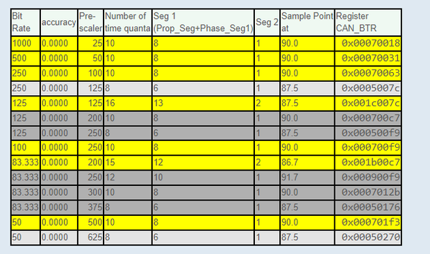

2024-10-18 1:31 AM
http://www.bittiming.can-wiki.info/
You need to have a second CAN node to transmit to and you need a proper CAN bus termination with the 120Ohm resistor on each end. Or you have to set the CAN controller to loopback.

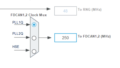

2024-10-18 1:50 AM
I was mistaken about APB1, which is use on other STM32.
The H563 has it's own clock for the FDCAN
Default is 8MHz, but i changed it to 250MHz. So the above chart i posted works

Still not able to get anything on the logic analyzer, both TX and RX stays high all the time not getting any data transmitted. Please refer to the below code

2024-10-18 3:50 AM - edited 2024-10-18 4:45 AM
First, you don't need a transceiver in the Loopback mode.
Second, as you are in Classic mode, these parameters are wrong for transmit as these are for FDCAN.
txHeader.DataLength = FDCAN_DLC_BYTES_12;
txHeader.BitRateSwitch = FDCAN_BRS_ON;
txHeader.FDFormat = FDCAN_FD_CAN;
So you need to use these parameters instead:
txHeader.DataLength = FDCAN_DLC_BYTES_8; /* maximum 8 bytes*/
txHeader.BitRateSwitch = FDCAN_BRS_OFF;
txHeader.FDFormat = FDCAN_CLASSIC_CAN;
Please refer to this example on Github:
PS: only Tx pin can be probed with your analyzer.
