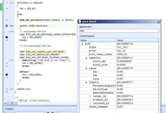

I went deeper in the code trying to find where the error is being generated and I reached the following:
DRESULT USBH_read(BYTE *buff, DWORD sector, UINT count){ DRESULT res = RES_ERROR; MSC_LUNTypeDef info; USBH_StatusTypeDef status = USBH_OK; DWORD scratch [_MAX_SS / 4]; if ((DWORD)buff & 3) /* DMA Alignment issue, do single up to aligned buffer */ { while ((count--)&&(status == USBH_OK)) { status = USBH_MSC_Read(&HOST_HANDLE, 0, sector + count, (uint8_t *)scratch, 1); if(status == USBH_OK) { memcpy (&buff[count * _MAX_SS] ,scratch, _MAX_SS); } else { break; } } } else { status = USBH_MSC_Read(&HOST_HANDLE, 0, sector, buff, count); } if(status == USBH_OK) { res = RES_OK; } else { USBH_MSC_GetLUNInfo(&HOST_HANDLE, 0, &info); switch (info.sense.asc) { case SCSI_ASC_LOGICAL_UNIT_NOT_READY: case SCSI_ASC_MEDIUM_NOT_PRESENT: case SCSI_ASC_NOT_READY_TO_READY_CHANGE: USBH_ErrLog (''USB Disk is not ready!''); res = RES_NOTRDY; break; default:res = RES_ERROR;
break; } } return res;}If you look a little deeper, in the function called to obtain the error source (USBH_MSC_GetLUNInfo());USBH_StatusTypeDef USBH_MSC_GetLUNInfo(USBH_HandleTypeDef *phost, uint8_t lun, MSC_LUNTypeDef *info){ MSC_HandleTypeDef *MSC_Handle = (MSC_HandleTypeDef *) phost->pActiveClass->pData; if(phost->gState == HOST_CLASS) { USBH_memcpy(info,&MSC_Handle->unit[lun], sizeof(MSC_LUNTypeDef)); return USBH_OK; } else {return USBH_FAIL;
}}Anyone knows something which may help me?Thanks in advance!2015-04-08 11:39 AM
In fact, the variable used in the switch have the value 0x00, which is:
#define SCSI_ASC_NO_ADDITIONAL_SENSE_INFORMATION 0x00
#define SCSI_ASC_LOGICAL_UNIT_NOT_READY 0x04#define SCSI_ASC_INVALID_FIELD_IN_CDB 0x24#define SCSI_ASC_WRITE_PROTECTED 0x27#define SCSI_ASC_FORMAT_ERROR 0x31#define SCSI_ASC_INVALID_COMMAND_OPERATION_CODE 0x20#define SCSI_ASC_NOT_READY_TO_READY_CHANGE 0x28#define SCSI_ASC_MEDIUM_NOT_PRESENT 0x3AWe’re moving the ST Community to a new platform to give you a better and more reliable community experience.
