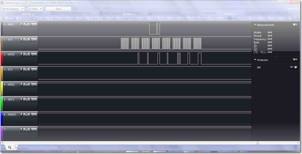

I've tested xmit_spi_multi and it did the job properly,
void test_function()
//test function from diskio.c here
uint8_t data_test[8] = { 0x00,0x01,0x02,0x03,0x04,0x05,0x06,0x07 };
xmit_spi_multi (data_test,8);
//test only
void xmit_spi_multi (
BYTE *p, /* Data block to be sent */
UINT cnt
while(HAL_SPI_GetState(&hspi2) != HAL_SPI_STATE_READY);
HAL_SPI_Transmit(&hspi2,p,cnt,100);
