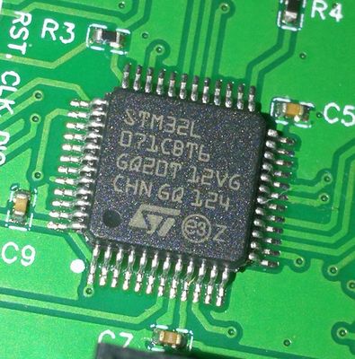

Pictures of the device, large, close, sharp and in-focus would be most telling.
The error is more indicative of the BOOT0 pin not being pulled low, or some intrinsically different Option Bytes settings related to the boot mode, nBoot or whatever.

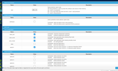

Open a connection to the device with STM32 Cube Programmer, screen shot of that, and the option bytes tab.
