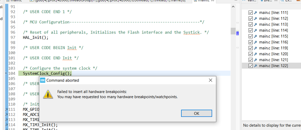

I started getting this message when I try to debug my code. However, there are currently no breakpoints in my code at all. I have gotten this in the past and I deleted and redownloaded the IDE which I really do not want to do again. I am running it on Mac. Any suggestions are helpful.

I get this error in cubeIDE when indeed i add more than 6 breakout points.
I can resume normal debugging when i remove breakout points down to 6

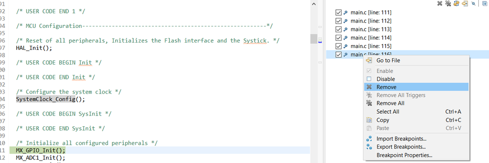

Encountered today the same problem today - no breakpoints in the breakpoint view, used brk / del debugger commands to delete all breakpoints but still no luck.
Eventually figured out that the function, where I wanted to put the breakpoint in, was likely optimised to inline and the IDE was actually trying to insert multiple breakpoints instead of one - and I only had 3 HW breakpoints available in the MCU.
If that is the case need to disable optimisation or find another way/place to insert the breakpoint.

Also had this problem today, and want to reiterate what the above commenter said: If you put a breakpoint in an inline function, it's like putting a breakpoint wherever that function is called/inlined. In my case I removed the inline keyword temporarily...

Your could try to start the application in the debugger (run to main), switch to mixed / instruction stepping, and set the breakpoint there, at assembler level.
I don't do Cube either, but this works fine with SeggerES.
