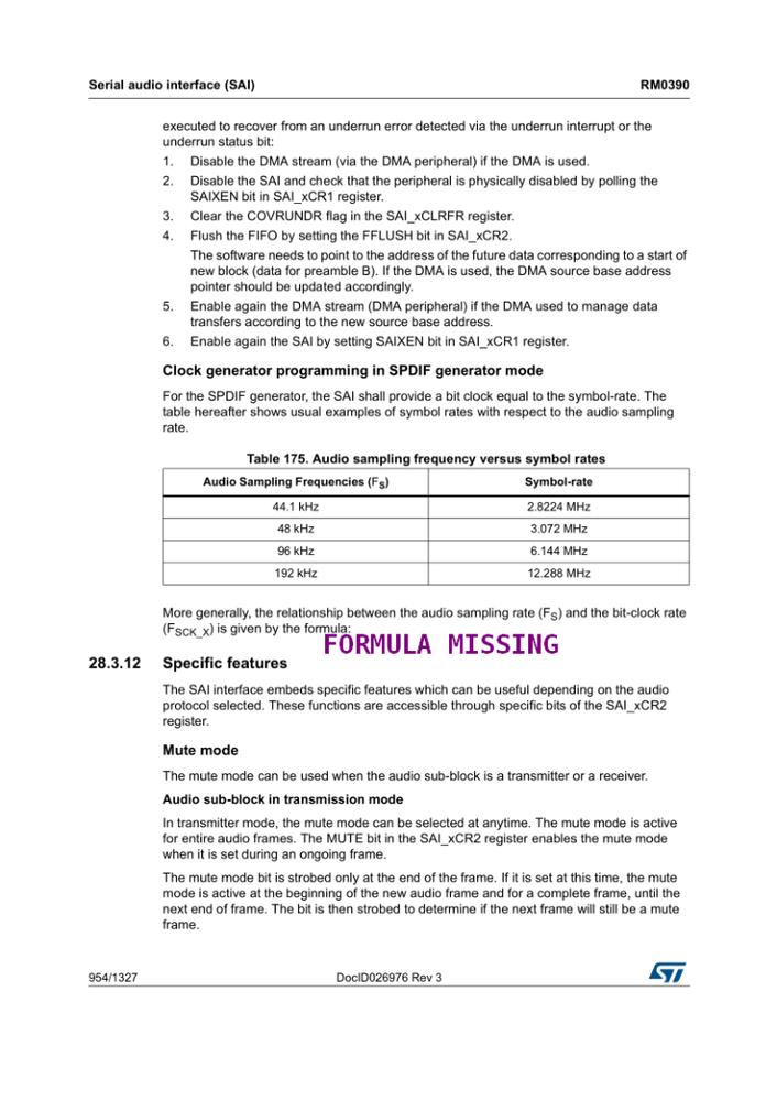

On second thought - I've seen the formula in other RMs, but IMO that formula ought to be given in terms of SAI signals as defined and SAI registers fields (namely MCLK), as it's different than clocking in free protocol modes (in that FRL is ignored).
The formula at MCLK's description ought to say so, too.

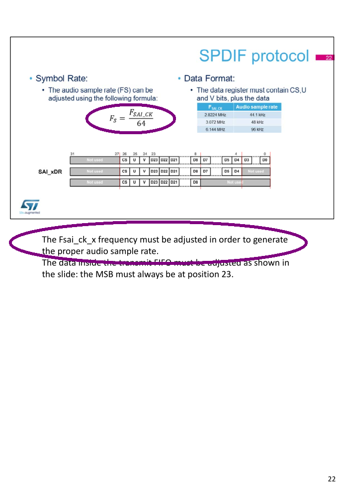

The formula I mentioned above I've seen in 'F7 documentation is wrong anyway:
as fS is not fSCK_x/64; and certainly not fSAI_CK_x / 64.

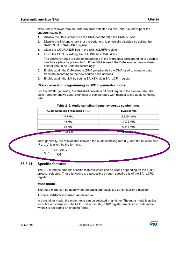

And this is wrong, too:
as it's not just the input frequency to SAI block, i.e. fSAI_CK_x , which is alone responsible for the resulting sampling frequency.

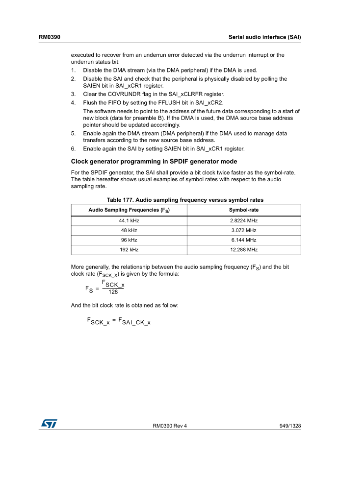

While in the new RM, the formula is there:
it's only partially true. As I've said above, fSCK_x follows the same formula as in FREE mode, with that the setting in FRL is ignored and is taken as if is fixed (FRL+1)=64.
Thus:
if NODIV=1 fSCK_x = fSAI_CK_x
If NODIV=0 and MCKDIV=0, fSCK_x = fSAI_CK_x / 4
If NODIV=0 and MCKDIV>0, fSCK_x = fSAI_CK_x / (8 * MCKDIV)
