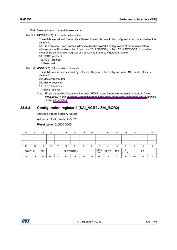

These clearly contradict. So, which one of them is true?

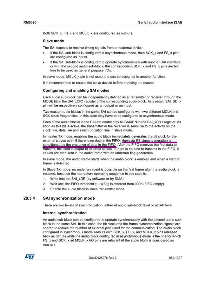

,This is the right sentence in RM0390 Rev 4, page934:
However FS signal generation is conditioned by the presence of data in the FIFO.
The note in page962 (RM0390 Rev 4) will bealigned with thecorrect
sentence in page9
