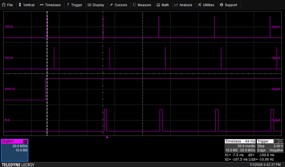

Hi Guys,
I have some issues with my master-slave time configuration. I simply chain TIM4->TIM1, whereas TIM4 triggers TIM1 every *** ms. As a result TIM1 responds with a single pulse on channel 1. The issue is now that the first pulse of TIM1 is not output as you can see in the picture below. You can also see that the master trigger (channel 2) is generated, but not the trigger for the slave-timer. Those somebody have a hint for me? Or can point me into the right direction?/* === variables === */
