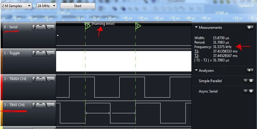

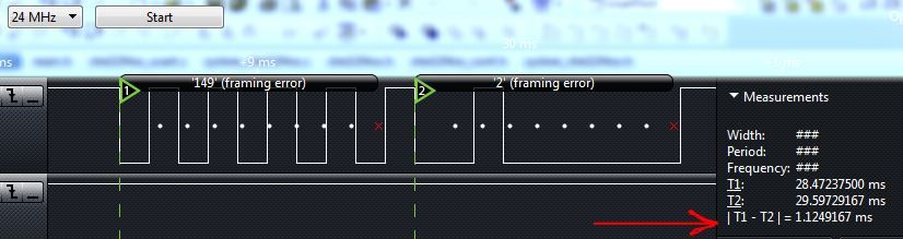

example to switch to USART1 again, so i can show the problem. I initialize the SystemInit(); at startup. And the picture shows the USART1 TX output at 9600 baud setting in STM32/**
* @brief Configure the TIM10 Ouput Channels.
* @param None
* @retval None
void TIM_Config_TIM10(void)
GPIO_InitTypeDef GPIO_InitStructure;
TIM_TimeBaseInitTypeDef TIM_TimeBaseStructure;
TIM_OCInitTypeDef TIM_OCInitStructure;
uint16_t CCR1_Val = 333;
uint16_t PrescalerValue = 0;
/* TIM10 clock enable */
RCC_APB2PeriphClockCmd(RCC_APB2Periph_TIM10, ENABLE);
/* GPIOF clock enable */
RCC_AHB1PeriphClockCmd(RCC_AHB1Periph_GPIOB, ENABLE);
/* GPIOF Configuration: TIM10 CH1 (PB8) */
GPIO_InitStructure.GPIO_Pin = GPIO_Pin_8 ;
GPIO_InitStructure.GPIO_Mode = GPIO_Mode_AF;
GPIO_InitStructure.GPIO_Speed = GPIO_Speed_100MHz;
GPIO_InitStructure.GPIO_OType = GPIO_OType_PP;
GPIO_InitStructure.GPIO_PuPd = GPIO_PuPd_UP ;
GPIO_Init(GPIOB, &GPIO_InitStructure);
/* Connect TIM pins to AF3 */
GPIO_PinAFConfig(GPIOB, GPIO_PinSource8, GPIO_AF_TIM10);

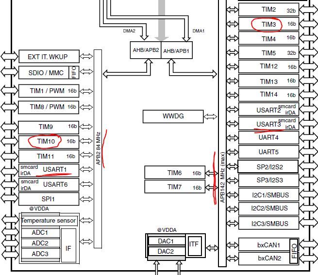

TIM10 Configuration: generate 1 PWM signal:
In this example TIM10 input clock (TIM10CLK) is set to 2 * APB2 clock (PCLK2),
since APB2 prescaler is different from 1.
TIM10CLK = 2 * PCLK2
PCLK2 = HCLK / 2
=> TIM10CLK = HCLK = SystemCoreClock
To get TIM10 counter clock at 21 MHz, the prescaler is computed as follows:
Prescaler = (TIM10CLK / TIM10 counter clock) - 1
Prescaler = (SystemCoreClock /21 MHz) - 1
To get TIM10 output clock at 530 KHz, the period (TIM10_ARR) is computed as follows:
ARR = (TIM10 counter clock / TIM10 output clock) - 1
= 665
TIM10 Channel1 duty cycle = (TIM10_CCR1/ TIM10_ARR)* 100 = 50%
Note:
SystemCoreClock variable holds HCLK frequency and is defined in system_stm32f4xx.c file.
Each time the core clock (HCLK) changes, user had to call SystemCoreClockUpdate()
function to update SystemCoreClock variable value. Otherwise, any configuration
based on this variable will be incorrect.
CCR1_Val = 333;
/* Compute the prescaler value */
PrescalerValue = (uint16_t) (168000000 / 21000000) - 1;
/* Time base configuration */
TIM_TimeBaseStructure.TIM_Period = 665;
TIM_TimeBaseStructure.TIM_Prescaler = PrescalerValue;
TIM_TimeBaseStructure.TIM_ClockDivision = 0;
TIM_TimeBaseStructure.TIM_CounterMode = TIM_CounterMode_Up;
TIM_TimeBaseInit(TIM10, &TIM_TimeBaseStructure);
/* PWM1 Mode configuration: Channel1 */
TIM_OCInitStructure.TIM_OCMode = TIM_OCMode_PWM1;
TIM_OCInitStructure.TIM_OutputState = TIM_OutputState_Enable;
TIM_OCInitStructure.TIM_Pulse = CCR1_Val;
TIM_OCInitStructure.TIM_OCPolarity = TIM_OCPolarity_High;
TIM_OC1Init(TIM10, &TIM_OCInitStructure);
TIM_OC1PreloadConfig(TIM10, TIM_OCPreload_Enable);
TIM_ARRPreloadConfig(TIM10, ENABLE);
/* TIM10 enable counter */
TIM_Cmd(TIM10, ENABLE);
* @param None
* @retval None
void TIM_Config_TIM3(void)
uint32_t TIM3CLK = 0;
/* TIM3 clock enable */
RCC_APB1PeriphClockCmd(RCC_APB1Periph_TIM3, ENABLE);
/* GPIOC clock enable */
RCC_AHB1PeriphClockCmd(RCC_AHB1Periph_GPIOC, ENABLE);
/* GPIOF Configuration: TIM3 CH1 (PC6) */
GPIO_InitStructure.GPIO_Pin = GPIO_Pin_6 ;
GPIO_Init(GPIOC, &GPIO_InitStructure);
/* Connect TIM pins to AF2 */
GPIO_PinAFConfig(GPIOC, GPIO_PinSource6, GPIO_AF_TIM3);
TIM3 Configuration: generate 1 PWM signal:
In this example TIM3 input clock (TIM3CLK) is set to 2 * APB1 clock (PCLK1),
since APB1 prescaler is different from 1.
TIM3CLK = 2 * PCLK1
PCLK1 = HCLK / 4
=> TIM3CLK = HCLK/2 = SystemCoreClock/2
To get TIM3 counter clock at 21 MHz, the prescaler is computed as follows:
Prescaler = (TIM3CLK / TIM3 counter clock) - 1
Prescaler = (TIM3CLK /21 MHz) - 1
To get TIM3 output clock at 530 KHz, the period (TIM3_ARR) is computed as follows:
ARR = (TIM3 counter clock / TIM3 output clock) - 1
= 665
TIM3 Channel1 duty cycle = (TIM3_CCR1/ TIM3_ARR)* 100 = 50%
Note:
CCR1_Val = 333;
TIM3CLK = 84000000;
PrescalerValue = (uint16_t) (TIM3CLK / 21000000) - 1;
TIM_TimeBaseInit(TIM3, &TIM_TimeBaseStructure);
TIM_OC1Init(TIM3, &TIM_OCInitStructure);
TIM_OC1PreloadConfig(TIM3, TIM_OCPreload_Enable);
TIM_ARRPreloadConfig(TIM3, ENABLE);
/* TIM3 enable counter */
TIM_Cmd(TIM3, ENABLE);
} Any ideas ????? i hope because i going nuts :) I have added the code so the hole thing can be check. (see /public/STe2ecommunities/mcu/Lists/cortex_mx_stm32/DispForm.aspx?ID=33044&RootFolder=/public/STe2ecommunities/mcu/Lists/cortex_mx_stm32/F4%20usart%20clock%20problem
View Properties/Attachments) ________________ Attachments : F4_UART_V2.rar : https://st--c.eu10.content.force.com/sfc/dist/version/download/?oid=00Db0000000YtG6&ids=0680X000006I1Bw&d=%2Fa%2F0X0000000bkD%2FeqrwktMXL4cZBSeSE6duWntL.QuHrkNBImNYAFzfPbs&asPdf=false2013-08-11 3:05 AM
Okay, found a workaround, but not why the ST code fails.
I started calculating the BRR by hand, and later found some code that i modified to a function that returns the BRR In the USART config, i added this call in the end, just before turning the USART on.// Set real BRR
USARTx->BRR = CalcUSART_BRR(9600, 42000000,0);
in this example i am using USART3, and the function i created wants (baud, APB clock, oversamplingEnabled)
And now it works for both USART1 and USART3 with both oversampling ON and OFF

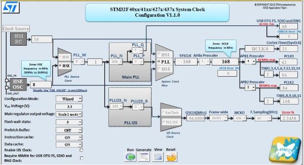

You sure the HSE_VALUE has been correctly defined?
You should also be able to route internal clocks via the MCOx pins if you need to verify them.2013-08-12 12:25 AM
Hi Clive.
Yes that was my first check. I added 2 lines in main.c so i could check the HSI_VALUE and added __NO_SYSTEM_INIT in preprocessor definition so i could check HSI_VALUE before theSystemInit();
The debugger says it is 8MHz, but it's strange because the UART timefram time do not change if a change the HSI_VALUE to something else, like 1MHzint main(void)
{ // Only used to check the osc reference values while debug so they are correct uint32_t T1 = HSE_VALUE; uint32_t T2 = HSI_VALUE; /* System Clocks Configuration **********************************************/ SystemInit(); I tested to fetch the clock data I debugged this codeint main(void)
{ // Only used to check the osc reference values while debug so they are correct uint32_t T1 = HSE_VALUE; uint32_t T2 = HSI_VALUE; uint8_t dummy = 0; RCC_ClocksTypeDef RCC_ClocksStatus; /* Configure the USART Baud Rate */ RCC_GetClocksFreq(&RCC_ClocksStatus); dummy = 1; <- I put the first breakpoint here /* System Clocks Configuration **********************************************/ SystemInit(); /* Configure the USART Baud Rate */ RCC_GetClocksFreq(&RCC_ClocksStatus); dummy = 2; <- I put the second breakpoint here and i got At first breakpoint (all in decimal)RCC_GetClocksFreq(&RCC_ClocksStatus);
