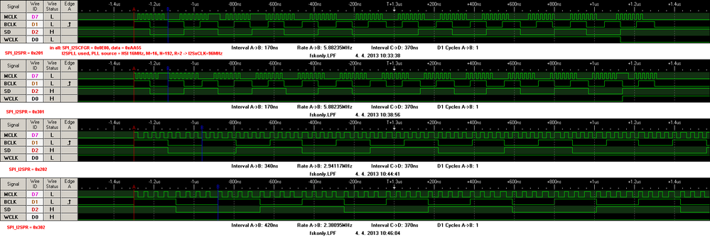

> I make some intensive tests, and with I2SDIV=1 it works fine, did not see any problem.
Probably not intensive enough - I do see problems - with I2SDIV=1 , ODD=1 appears to be ignored.
This is not to say that I2SDIV=1 and ODD=0 will work under any circumstances.
(The missing MCO pulses are due to sampling rate of LA set to too low - 100MHz - sorry).

The first and third waveforms were taken with ODD=0 - the whole SPI_I2SPR register is given under each waveform.
