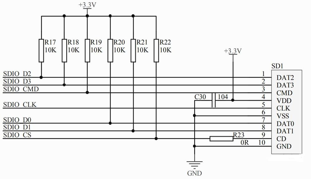

And here is my PCB SD card wiring part:

I found something interesting.
In CubeMX generated code SD plug-in detecting function look like this:
uint8_t BSP_PlatformIsDetected(void) {
uint8_t status = (uint8_t)0x01; /* Check SD card detect pin */ if (HAL_GPIO_ReadPin(SD_PORT,SD_PIN) == GPIO_PIN_RESET) { status = (uint8_t)0x00; } /* USER CODE BEGIN 1 */ /* user code can be inserted here */ /* USER CODE END 1 */ return status;}So we know if the card detecting pin which is pin 9 in above figure connect to GND, this function will return 0. And result 0 will cause the caller function return a SD_NOT_PRESENT status.
Now take a look in demo project provided by firmware pack:
&sharpdefine SD_PRESENT ((uint8_t)0x01)
&sharpdefine SD_NOT_PRESENT ((uint8_t)0x00)uint8_t BSP_SD_IsDetected(void)
{ __IO uint8_t status = SD_PRESENT;/* Check SD card detect pin */
if(HAL_GPIO_ReadPin(SD_DETECT_GPIO_PORT, SD_DETECT_PIN) != GPIO_PIN_RESET) { status = SD_NOT_PRESENT; } return status;}In this case, the same pin state will get opposite result.
DAHMEN.IMEN
don't know if it is a reported bug or some setting I can configure in CubeMX. Normally, we connect the CD pin to a pull-up resistor, when a card insert it connect to ground. #sdio #microsd #sd-card2018-04-02 5:37 AM

2018-04-04 12:54 AM
I simply did these two operation make my CubeMX project works.
1.Go to sdio.c file, MX_SDIO_Init(void) function, line 74,
Change this line to below:
hsd.Init.ClockDiv = SDIO_TRANSFER_CLK_DIV; //CubeMX advised to place 0 here, but won't work for mine
2.Go to fatfs_platform.c file, BSP_PlatformIsDetected(void) function,line 53,
if (HAL_GPIO_ReadPin(SD_PORT,SD_PIN) != GPIO_PIN_RESET) { //if CD pin connect to GND,means card is inserted
Now build the the project, and FATFS will work, if your situation is the same to mine.
