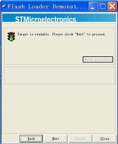

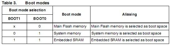

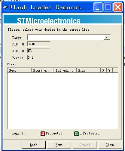

now the F0 DISCOVERY can enter the BOOT0 MODE, I download the UART tool ' Flash_Loader_Demonstrator_v2.5.0', it can read the IC ,but it seem can't support it
2012-08-08 12:36 AM
the 'flash_loader2.5' is the newest version i can download from the website
