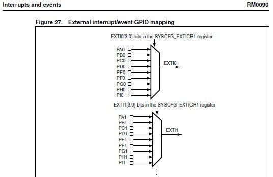

If I understand correctly PA3 is not connected to EXTI line 0?
could you tell me where to find a table or something similar indicating EXTI_LINE and pin to which it is associated? I looked in the manual but could not find, maybe try with the wrong name or something.2012-11-12 12:13 PM
Px3 goes to EXTI3
