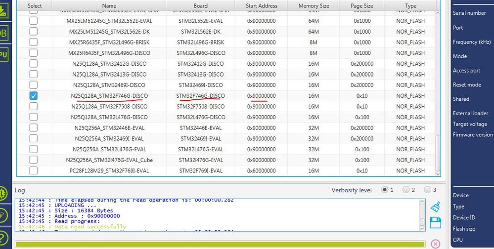

2020-09-12 1:57 AM
@Community member Hi, I tried but got issue. Can you please check this link ? Thanks
