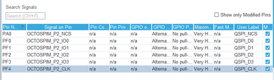

The pinout of this peripheral on my custom PCB is:
I have also checked that I can read and write data to the flash, so the wiring should be fine.

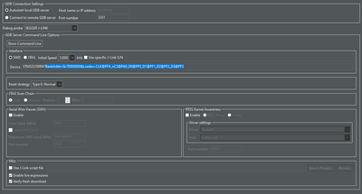

So, based on this I modified my run script like this:
But I am getting this, when I am trying to download my app to the device:

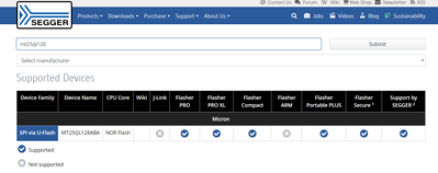

I am having similar issue with MT25QL128. Unfortunately Jlink does not support
