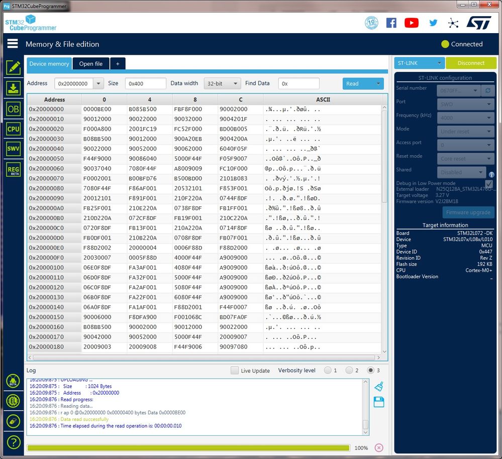

2021-11-10 2:23 PM
You can also get the tools to read the RAM. Note on the H7 series 0x24000004 is used..
