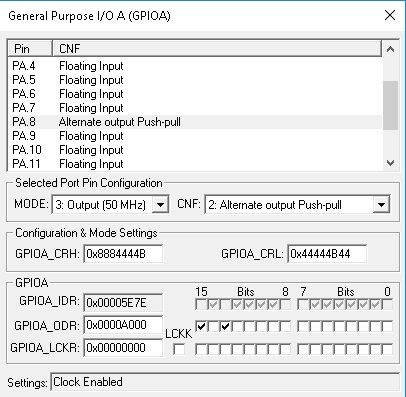

GPIO_InitStructure.GPIO_Mode=GPIO_Mode_AF_PP;
Consider using GPIO_Mode_IN_FLOATING for an INPUT

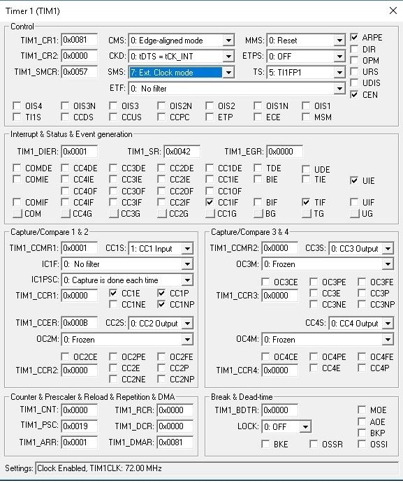

Period = 1 ?? Not going to count very much
Clocking code in system_stm32f1xx.c going to differ between 103 and 107 series parts, check input clock, PLL settings.
Consider using PA8 as MCO to probe internal clocks.
Double check pin utilization in data sheets for two parts.
Not Working? What type of input is being applied, and what happens in the work vs not-working case? What are the register settings in TIM3 when you dump out or view in debugger?

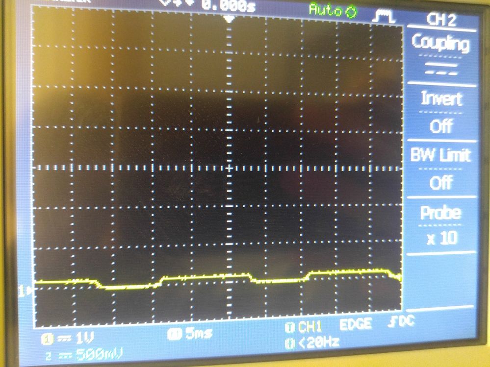

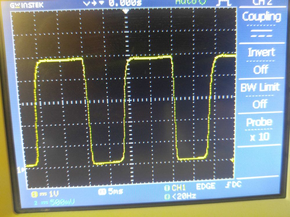

Hello I have to change my timer to timer 1 and this is my code
RCC_APB2PeriphClockCmd(RCC_APB2Periph_TIM1 ,ENABLE);
RCC_APB2PeriphClockCmd(RCC_APB2Periph_GPIOA|RCC_APB2Periph_AFIO, ENABLE); // GPIO_PinRemapConfig(GPIO_FullRemap_TIM3,ENABLE);GPIO_InitTypeDef GPIO_InitStructure;
GPIO_InitStructure.GPIO_Pin = GPIO_Pin_8; GPIO_InitStructure.GPIO_Mode=GPIO_Mode_AF_PP; GPIO_InitStructure.GPIO_Speed = GPIO_Speed_50MHz; GPIO_Init(GPIOA, &GPIO_InitStructure); TIM_TimeBaseInitTypeDef TIM_TimeBaseStructure; TIM_TimeBaseStructure.TIM_Period = 1; TIM_TimeBaseStructure.TIM_Prescaler = 25; TIM_TimeBaseStructure.TIM_ClockDivision = TIM_CKD_DIV1; TIM_TimeBaseStructure.TIM_CounterMode = TIM_CounterMode_Up; TIM_TimeBaseStructure.TIM_RepetitionCounter=0; TIM_TimeBaseInit(TIM1, &TIM_TimeBaseStructure); TIM_ARRPreloadConfig(TIM1,ENABLE); TIM_SelectInputTrigger(TIM1, TIM_TS_TI1FP1); TIM_TIxExternalClockConfig (TIM1, TIM_TS_TI1FP1, TIM_ICPolarity_BothEdge, 0) ; TIM_SelectSlaveMode(TIM1, TIM_SlaveMode_External1); TIM_ITConfig(TIM1, TIM_IT_Update, ENABLE); NVIC_InitTypeDef NVIC_InitStructure;/* Enable the TIM1 global Interrupt */
NVIC_InitStructure.NVIC_IRQChannel = TIM1_UP_IRQn; NVIC_InitStructure.NVIC_IRQChannelPreemptionPriority = 2;NVIC_InitStructure.NVIC_IRQChannelSubPriority = 0;
NVIC_InitStructure.NVIC_IRQChannelCmd = ENABLE; NVIC_Init(&NVIC_InitStructure); TIM_Cmd(TIM1,ENABLE);when i conncet pulse to pin a 8 the pulse change .
please help me.how can i fix it?
before connect to pin a 8
after connect to pin a 8
2017-10-22 8:44 AM
