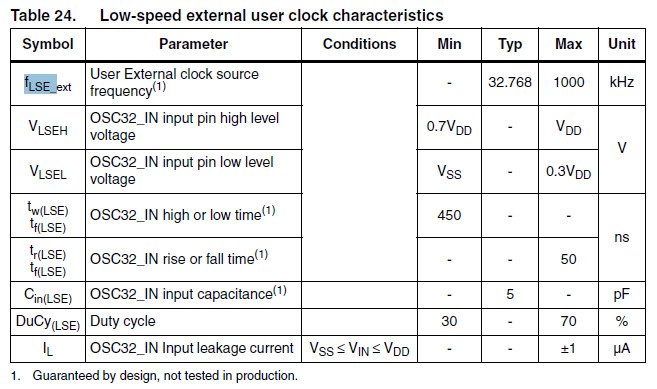

> The LSE could use a 256 or 512 KHz crystal.
Inventive, although... I can't find any information on the capability of the LSE circuitry to drive anything other than a 32.768kHz crystal... JW2013-04-08 7:31 AM
Connectivity via MCO, TIM5 and TIM11
2013-04-08 7:47 AM
It's not a coincidence that this table is found under ''Low-speed external user clock generated from an external source'' header.
I'd be very surprised if this would constitute a guarantee that the LSE circuitry can drive a 512kHz crystal. JW2013-04-08 7:47 AM
