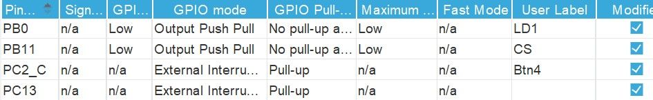

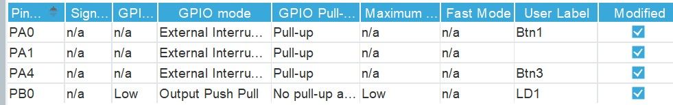

2024-11-13 5:39 AM
Hi i had checked and re-check the Pins assignment as screenshot and code below:
void HAL_GPIO_EXTI_Callback(uint16_t GPIO_Pin)
if (GPIO_Pin == Btn1_Pin) // PIN_0
// LED1 on
else if (GPIO_Pin == GPIO_PIN_1)
// LED2 ON
else if (GPIO_Pin == Btn2_Pin)
// LED 3 ON
else if (GPIO_Pin == Btn3_Pin)
// LED3 ON;
else if (GPIO_Pin == GPIO_PIN_13)
// LED 4 ON
}below,
2024-11-13 5:56 AM - edited 2024-11-13 6:05 AM
Hello @HMSEdinburge ,
First, I have remarks regarding the info you provided:
@HMSEdinburge wrote:
enabled NVIC interrupt, GPIO pull-up, interrupt with rising edge triggered,
-> You set pull up and you set the EXTI edge to rising which is not correct. You need either to set pull-up resistor and set the edge to falling or set pull-down resistor and set the edge to rising.
Hello, I'm using H723 Nucleo. I set 5 ext interrupt pins: PA0, PA1, PA4, PC2_C, and PC13
PA1 is connected to the ETH PHY RMII_REF_CLK pin on the board. need to select another pin. PC13 is used by the user button which has already an external pull-down resistor. So no need to set pull up/down internal resistor.
Now regarding the code, this is how it could be managed:
switch(GPIO_Pin)
case GPIO_PIN_0: exti_source = 1; break; // PA0
case GPIO_PIN_3: exti_source = 2; break; // PA3 instead of PA1
case GPIO_PIN_4: exti_source = 3; break; // PA4
case GPIO_PIN_2: exti_source = 4; break; // PC2_C
case GPIO_PIN_13: exti_source = 5; break; // PC13
default: exti_source= 0; break;
I've attached a project running on NUCLEO-H723 that uses all these EXTIs (just replaced PA1 by PA3) . Put exti_source in live watch and you can see the value that changes according to the EXTI event triggered.
Hope that answers your question.
