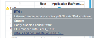

1- In the reference manual of the product:
Example:
Or move the cursor on it:
2- In the Driver folder.
3- There is no bootloader code generated by CubeMx. It's under the user responsibility.
4- No mass storage code generated by CubeMx at this level. You need to configure the interface in Host/Device etc .. And add the USB library (for example to add x-cube-usb-pd) in middleware section.

in the reference manual there does not seem to be any such table or list. I can only find those acronyms in the index. And obviously only those that do apply to that specific micro. It would be tedious to have to find and open countless manuals hoping it contains the acronym I am trying to figure out. So I was wondering if there is a list of all of them somewhere perhaps? Perhaps I misunderstood what you meant?

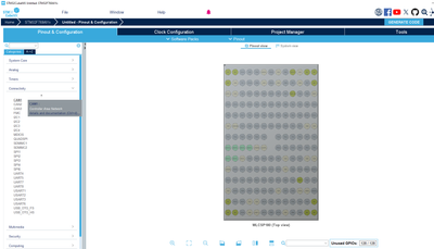

Which brings me in your second screenshot (copy below). That might seem a more immediate solution. Where did you take that screenshot from?
Both my MCUfinder app and the "New Project" Wizard (in CubeMX) don't have that pop-up, nor do they show those columns I can see in your screenshot (Boot, Application, ExtMem). Where is that screenshot from?

There is no table list of acronyms in the reference manual. The acronyms are part of each chapter title as I mentioned above.
I don't know for MCU finder, but the screendshot I've taken is from CubeMX.

I unmarked it as solved after I tried both CubeMX and MCUFinder and it did not work. Hovering above it does not give me the comment that does give to you (reason for asking the question above). I updated to the latest but, as mentioned, there still aren't pop-ups nor the extra columns shown in your screenshot.
Could you please retake the same screenshot but of the full screen so I can see where on CubeMX it is you have that pop-ups.

2024-12-25 11:58 PM
This is a screenshot from a created project for STM32F769:
Passing through the mouse cursor on CAN1, shows a popup describing the peripheral.
Try to click on the pinout view background and move back the mouse on the peripheral link.
I think MCU Finder does not support that feature. The screenshot you shared in your first comment corresponds to the examples available not to the peripheral configuration.
