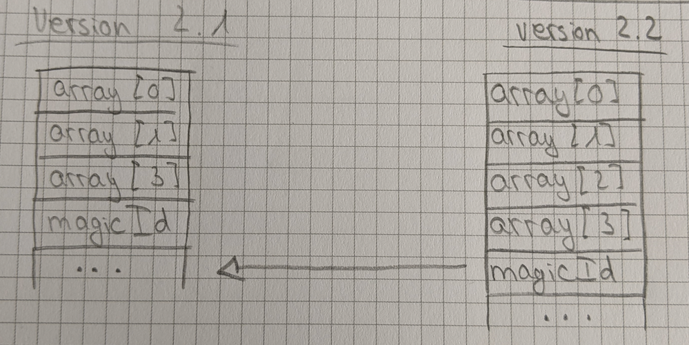

2022-07-05 3:19 AM
> If there is a new variable between 2 restarts, variables after this new will be shifted in memory and data will be lost
I don't understand, can you please elaborate more on this? Perhaps giving a simplified example? Or illustrate it with some drawing?
Are you talking about migration between old and new version of the firmware?
2022-07-05 3:33 AM
@Community member "I don't understand"
Neither do I.
For the struct to change in Flash, the code running on the STM32 would have to update it - so that update should ensure that data is not lost?
2022-07-05 4:12 AM
In both versions, at the begining there is a check of magicId, to know if the device's configuration needs to be updated (done by an app on PC). Value of magicId is always the same.
In the new version, if I expand the array, the location of magicId is shifted and does not have the correct value.
Hope it helps
2022-07-05 6:09 AM
That was a poor design choice, then!
magicId should be the very first thing in the struct - so that it will always be in the same place, irrespective of how the rest changes
