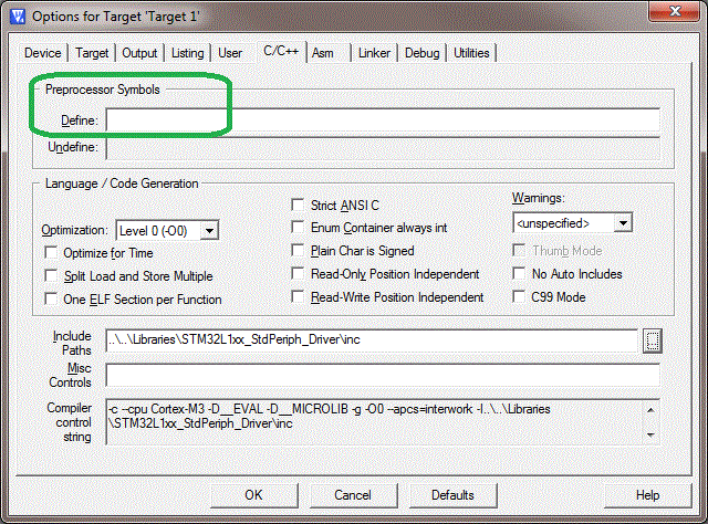

Clive,
I already have those files in my project folder and have the pathway to the folder containing all the files chosen.2015-03-18 12:13 PM
ZIP/RAR the project tree, I'll rack it up here and see. The error messages suggest it's not pulling that stuff in.

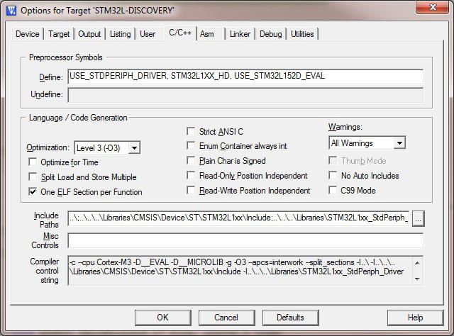

The other meta-data in the project are the preprocessor defines ''USE_STDPERIPH_DRIVER, STM32L1XX_HD, USE_STM32L152D_EVAL''
2015-03-20 3:23 AM
Thats my project that I have been trying to get working.
________________ Attachments : ro4.zip : https://st--c.eu10.content.force.com/sfc/dist/version/download/?oid=00Db0000000YtG6&ids=0680X000006HzzH&d=%2Fa%2F0X0000000bSM%2Fi9yOef9NeC0erU.HOd.o96yCuxyE1Majaa9o7TBjynU&asPdf=false2015-03-20 1:31 PM
Ok, that's just the project definition file, not the project. Doesn't look like you have the defines set.
