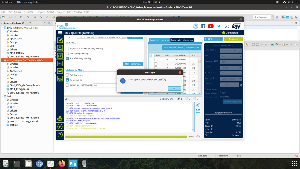

Found the solution,since it promoted the STM32CubeProgrammer CLI malfunction, so I programed the .elf file in a isolated Prog tool:
2021-02-26 7:18 PM
I guess it was due to I set the "TZEN" enabled, but when I unchecked it in STM32Prog, it was prompted:
Error: Expected value for Option Byte "TZEN": 0x0, found: 0x1
2021-02-26 8:46 PM
