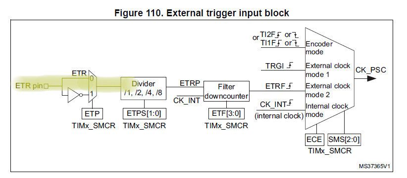

I tried to prescale the TIM2_ETR signal on STM32F401RC, to increase the bandwith.
In theory the ETR signal max frequency is 1/4 Fclock = 21 MHz, but it can be increased thanks to the prescaler. The RM0368 manual (STM32F401 reference manual) writes on page P356 " External trigger signal ETRP frequency must be at most 1/4 of CK_INT frequency. A prescaler can be enabled to reduce ETRP frequency. It is useful when inputting fast external clocks."
Indeed I could measure up to 21 MHz = 84MHz/4. Then I prescaled the ETR signal using "4" and "8" predefined prescaling values with this result:
I tried changing the GPIO speed without any change. Is there anything else to set to increase the bandwidth?

Here the input is ETR. If I am correct, there is no sync mechanism before the ETR prescaler. I tried to measure the highest frequency possible and increased in steps of 1 MHz. It works @ 20MHz, 21 MHz, then the measurement is false even when setting an ETR prescaler value.

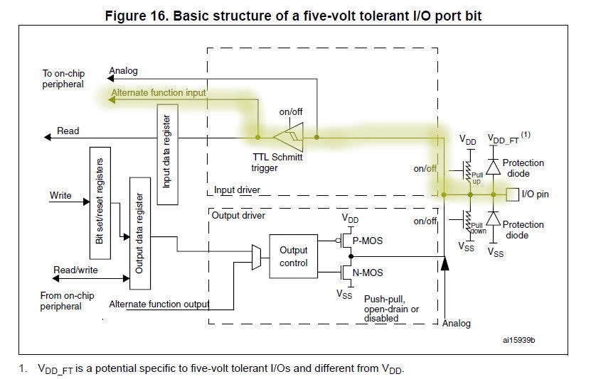

But, do you mean that all inputs have a resync mechanism? I am not talking about data acqusition. There is a signal to alternate function input after the schmidt trigger. I don't see any sync on the "Basic structure of a five-volt tolerant I/O port bit" Also I changed the speed settings of the IO just for a check, and it did not change the max frequency measurable (21 MHz).

Here are the two input block schematics. I don't see where they are synced anywhere before "ETPS"
