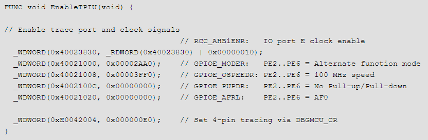

Here is the tutorial I found from keil.com.
http://www.keil.com/support/man/docs/ulinkpro/ulinkpro_stm32f10xxx_etm.htm

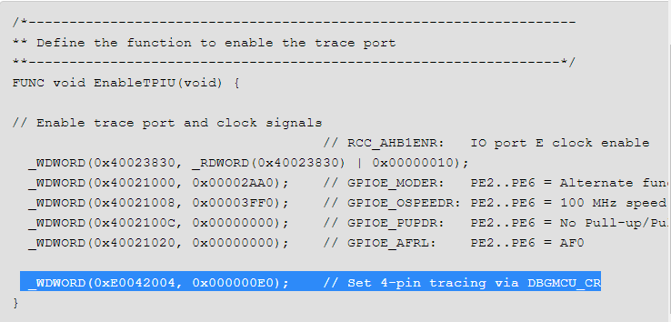

Here is the snipping.
So, when we need to using ETM trace, we just need to enable the Trace PORTs clock, and configure them as AFIO with highest speed, then set the DBGMCU_CR, that's it?

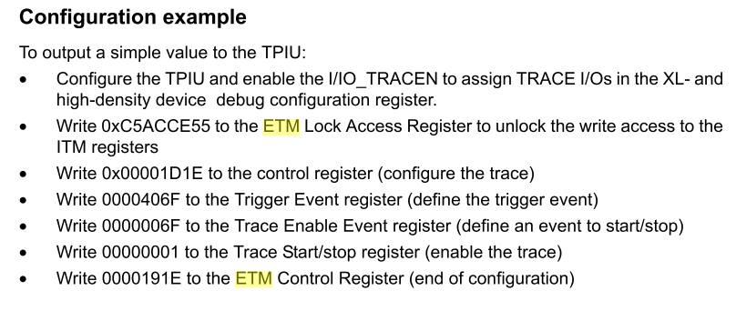

What I found in the STM32F107 user manual is this!
it looks different!

1) The code you display for the .ini file is to set the Trace Port GPIO pins to handle ETM the best.
2) The code you show from the ST manual is something different - this configures ETM inside the CoreSight module in the STM32.

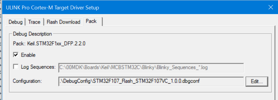

2) In the latest Software Pack - there is a new entry - in the Target Driver Setup window there is sometimes a new tab: Pack. See below. This can contain a file dbgconf as shown below. This is used instead of the .ini file in the older way.

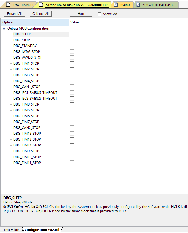

In the pack. I found this.
In my case, I will leave all unchecked.

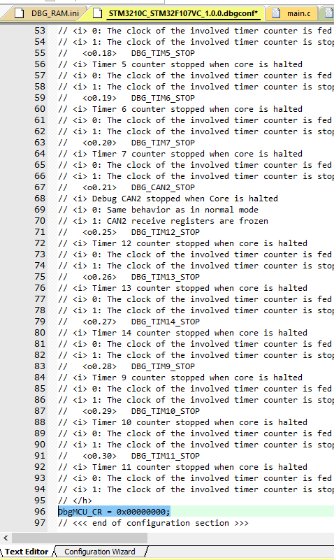

Then I look in the Text Editor.
DbgMCU_CR = 0x00000000; !!!
What is the pack doing?!!!
Maybe I can see the register
who will run first
.But this really get people confusing.
if
.dbgconf first, the finallyDbgMCU_CR will be rewrite to 0x000000E0. That is ok.
But if my *.ini file (Project - options - debug ) run first, DbgMCU_CR = 0;

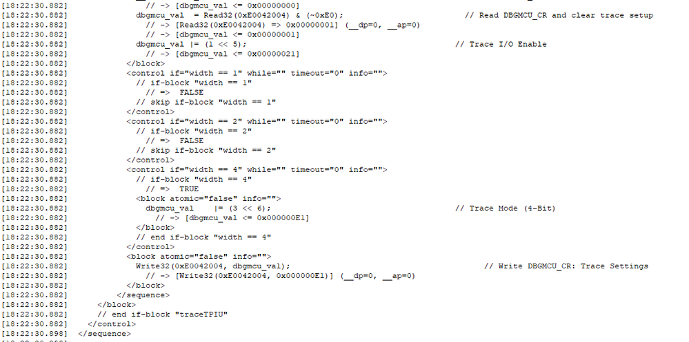

After I did some experiment on my STM3210C EVAL Plus ULink Pro.
Finally I know how to use the pack.

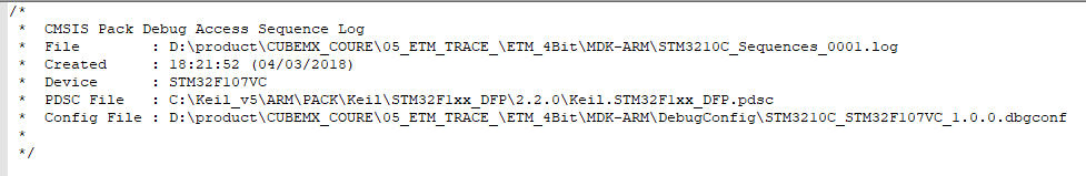

This is the snipping From the pack log file.
The pack did have ETM enabled.
