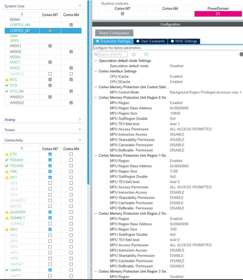

Hello @PGrif.2 ,
I don't seem to get the way you are setting your regions and sizes in MPU config, and it seem to be you issue. you need to make sure of the size of your regions and have in mind the Memory aliasing happening between CM4 and CM7 to get this right.

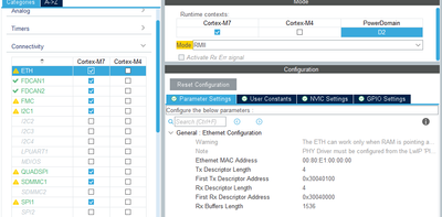

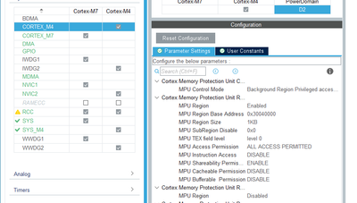

I used Adam Berlingers post How to create project for STM32H7 with Ethernet an... - STMicroelectronics Community (Thank you Adam!) but changed the MPU and ETH values as shown below, since the orginal posted values lead to the same issues as described here.
M7 settings for Ehternet
M4 settings for ADC to DMA
ETH connection
for more details see the attads .ioc and load files.
