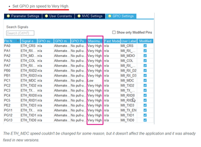

According to this wiki the ETH IOs are set to Very High:

So you need at least to set it to High speed but I recommend to set it to Very High speed.

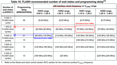

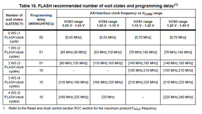

Your system is set to 200MHz and not 400MHz. The two projects are set to 200MHz one set to Flash WS=1 and the other WS=2.
Did you check that table in RM: Flash WS vs System frequency/VOS level?:

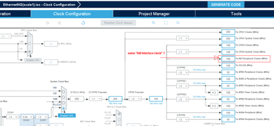

2024-04-11 6:16 AM
Thank you for your reply. :)
Sorry, It was my lack of explanation. The two attached ioc files are both set to 200MHz.
It seemed like the VOS setting was the only condition that changed Ethernet communication from OK to NG.
That's why I have attached a project with the same clock settings but different VOS settings.
Also, Ethernet doesn't work even for 400MHz projects. (EthernetNG(scale1)_400MHz.ioc)
I used the values automatically set by CubeMX for Flash WS settings, but is this incorrect?
Isn't "AXI Interface clock" in Table.16 the same as "AXI Peripheral Clocks" on CubeMX?
In that case, the clock is 100MHz and the Flash WS value looks normal.

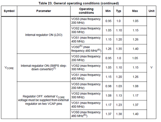

> Also check/monitor your VCORE voltage level according to the datasheet:
When VOS1 is selected, it supports up to 400MHz operation, so I understand that 200MHz operation is possible, but is this correct?
I would like to know the reason why Ethernet communication does not work on a custom board when VOS1 is selected.

2024-04-11 6:34 AM - edited 2024-04-11 6:47 AM
-> It should follow the AXI frequency not the system frequency. My bad...
-> Yes but you need to monitor VORE voltage on VCAP pins as it could be somthing related to the HW. The VCORE should be and constantly in the range stated in the DS according to the voltage level set. Is there a voltage drop/a glitch on VCAP pins?

2024-04-12 3:37 AM
I had the customer's board's VCAP voltage checked.
The voltage was within the datasheet specifications:
1. EthernetOK(scale3).ioc ... 200MHz, VOS scale3
=> VCAP 1.014V
2. EthernetNG(scale1).ioc ... 200MHz, VOS scale1
=> VCAP 1.218V
3. EthernetNG(scale1)_400MHz.ioc ... 400MHz, VOS scale1
=> VCAP 1.222V

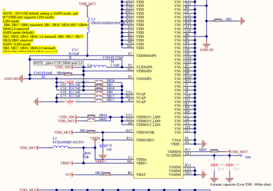

Also, I got the power schematic for the customer board.
Is there anything you are curious about about this schematic?
Please continue the support.

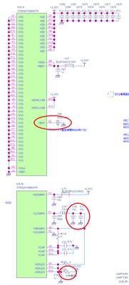

2024-04-12 11:34 AM - edited 2024-04-12 11:37 AM
I didn't look deeply at all your parts in your schematics but seems there are some doubts regarding the parts with red circles. In my analysis I'm based on the reference design provided by STM32H745-DISCO schematics.
1- No voltage refence at VBAT pin. Just connected to a capacitor. Needs to be connected to VDD if Backup domain is not used.
From RM:
2- I see two capacitors of 10u (C70/C71) mounted in parallel. In the reference design only one capacitor of 10u is used.
3- I have a doubt regarding R126 (0 ohm). Is that mounted? There is a Chinese text near to that resistor, does it mean: not mounted?

I suggest you to look deeply at STM32H745-DISCO board schematics in order to catch the differences/issues.
2024-04-15 1:08 AM
Hi, Thank you for your support. :)
I asked the person in charge of board development to confirm.
The points pointed out are the intended board design and there is no problem.
Also, just to be sure, even after correcting the points pointed out, the behavior did not change.
There has been progress in the investigation.
I heard that communication was possible by changing the Ethernet GPIO pin speed from "Low" to "Very High".
I have no knowledge about GPIO pin speeds.
Do different GPIO pin speeds affect Ethernet communication?
Should the Ethernet GPIO pins be at VeryHigh speed?

2024-04-15 4:33 AM - edited 2024-04-15 6:07 AM
2024-04-18 5:25 AM
Thanks for your support, I solved it. :)
Since the problem no longer occurs with VeryHigh, please close the ticket.
