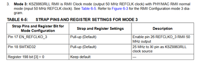

Is this true?
"to enable internal RMII clock (recommended by datasheet), a register only accessible via I2C / SPI must be written."
If using Clock mode 3 the IC does not require any registers to be set and can be left as default, as per the figure below.
I'm only mentioning this as I have not exposed the I2C interface on my design which I've just received from manufacture...

2024-09-16 4:47 AM
> Is this true?
On my board, unfortunately yes.
> ... I have not exposed the I2C interface on my design which I've just received from manufacture...
Oh my... the good news is, that the KSZ uses the same pins for I2C as for MDIO.
Have you wired at least the external clock output back to the input? If yes, and if you have a serial resistor replace it with 0R.
Question to @JR5 : from which datasheet version is that "table 6-5" ?
