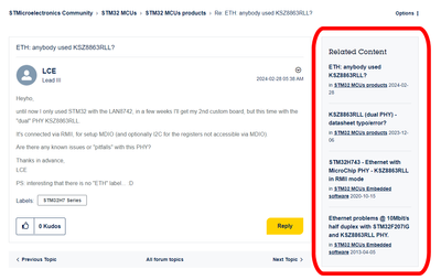

Just noticed:
2024-02-28 6:59 AM
Yes, I already found these, one thread was started by me...
And I'm not too bad at googling! ;)
