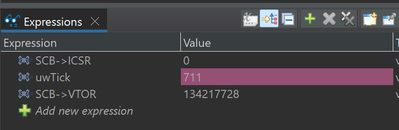

2024-08-26 10:12 PM
#define SCB_ICSR_VECTACTIVE_Pos 0U /*!< SCB ICSR: VECTACTIVE Position */
#define SCB_ICSR_VECTACTIVE_Msk (0x1FFUL /*<< SCB_ICSR_VECTACTIVE_Pos*/) /*!< SCB ICSR: VECTACTIVE Mask */
This is what I found looking for VECACTIVE.
I also modified the code to be SCB->VTOR points to 0x08000000 but could not solve.

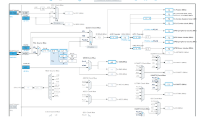

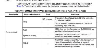

2024-08-26 11:45 PM
I checked the document and tried to apply it . I use this clock configuration
as I looked into this part of the document AN2606
The error is still the same .
Break at address "0x1fff40a2" with no debug information available, or outside of program code.
