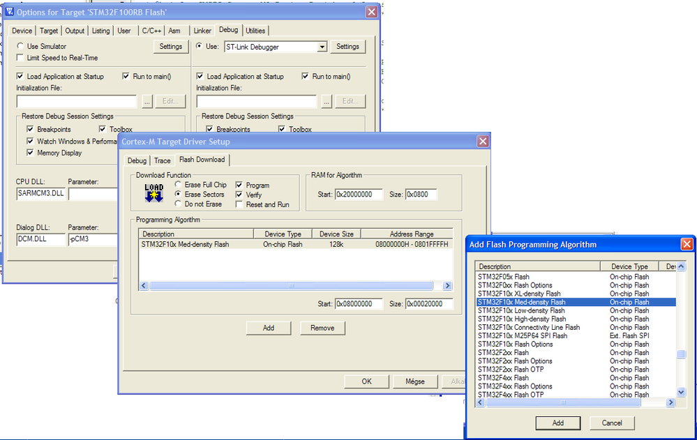

Please check the following settings regarding to the microcontroller you use.
2013-03-07 7:40 AM
That's more likely to get you an ''Error : Flash download failed'' condition.
No Algorithm found for: 08000000H - 0800256FH Erase skipped! The error mentioned often occurs as a result of the part not being powered, JTAG used instead of SWD, or the part being generally unresponsive to the debugger.2013-03-07 7:52 AM
Depending on the MDK version, I would try both ''ST-Link'' and ST-Link(Deprecated)'' as debug adapter.
And, as clive suggested, check that it is actually set to SWD (for the discovery-integrated version).2014-05-22 7:34 AM
