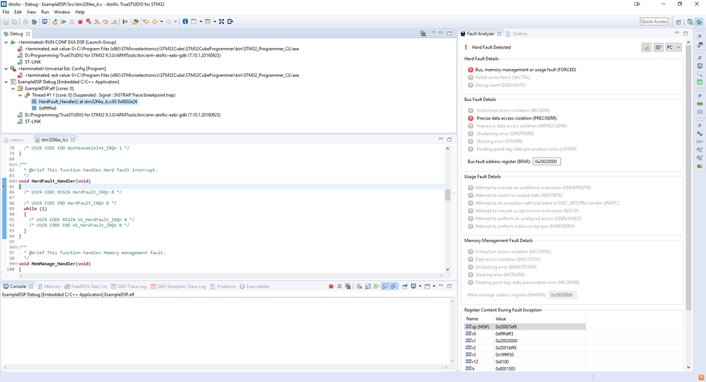

When I run my code (https://pastebin.com/37n0fS1F) I get a Hard Fault Error which I cannot find out how to resolve:
Bus, memory management or usage fault (FORCED)
Precise data access violation (PRECISERR)
Bus Fault Address Register (BFAR): 0x20020000For this I looked at the Fault analyzer in screenshot above, but I cannot figure out which line is causing the error in my program. I have been studying this document, but I with it I cannot solve my problem.

So blowing out the top of memory, suggestive that you have a stack based local/auto variable, and then other code walking it beyond scope.
Check dimension parameters.
Check the faulting code. What is the code at/immediately prior to the fault doing? What memory/array is it indexing?
You should have all the source, walk back the code tree, look at the parameters, confirm the expectations.
Here we usually start by having a USART/SWV debug channel working, and a Hard Fault Handler that can decompose the fault to the terminal.
