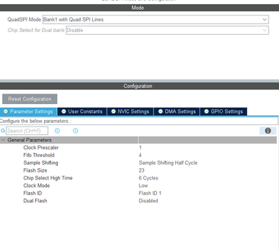

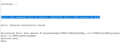

I recently created a custom board using the STM32F746. I'm encountering an issue with the QSPI interface. The problem arose when I replaced the external flash from the MT25QL128ABA model to the IS25LP128F model. I have checked the data sheet and adjusted the QSPI parameters accordingly, but I'm still facing the issue as shown in the attached image. I would appreciate your help with this.
(I haven't changed the code; I only adjusted the QSPI parameters in the .ioc file after generating the code from TouchGFX Designer.)

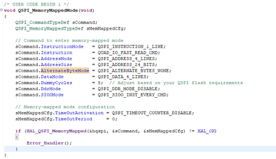

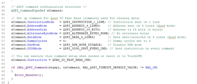

2024-08-18 5:14 PM
I studied 'dummy' and applied it based on your advice.
So I tried debugging by adding the following code to void MX_QUADSPI_Init(void)
However, I still get the following error

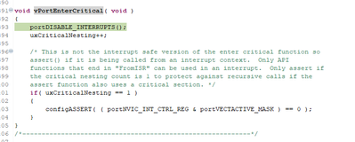

After that, an error occurred at MX_TouchGFX_Init() -> touchgfx_init() -> Texts::setLanguage(0) -> currentLanguageTypedText = typedTextDatabaseArray[id];

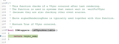

"After adding this function, it seems like there are no more errors, but my board doesn't work. When I press suspend, it stops at
There is no progress after this.
It seems that the error occurs at MX_TouchGFX_Process(); -> touchgfx_taskEntry() -> OSWrappers::isVSyncAvailable() -> return vsync_sem;

2024-08-21 8:46 AM
Ok, well a couple of things going on here.
The error about the mismatch is coming from the loader writing the content to memory, it's not related to any of your application code.

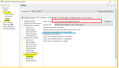

Thank you, everyone, for your answers. I had followed the instructions in
but it didn’t work well for me. After watching a video, I realized what I had missed, and it worked well afterward.
I underlined my mistake in blue, and you need to uncheck the box. I hope that anyone reading this doesn't make the same mistake as I did.
