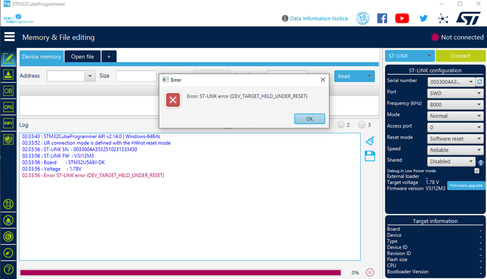

This resulted in the device being on constant reset or whatsoever I am unable to connect to the device, and seeing the error "DEV_TARGET_HELD_UNDER_RESET".
I believe I will be able to connect to the device with the ST-link in SWD mode, even there I cannot connect to the device anymore and program normally. Thus resulted into a bricked device kind of scenario.

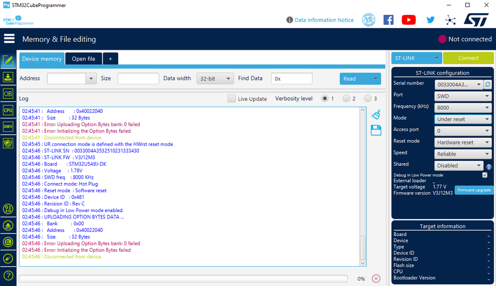

Interestingly I see whenever I try to connect to the device using the STM Cube programmer, in the console I see uploading option bytes, So I believe that the correct option byte will be written once I am able to connect to the device. Currently I am getting this error since the device is not able to connect.
I tried various ways to somehow connect the device with the st-link like even selecting the connection mode as "under reset", "hot plug", but I am not able to connect it anyway.

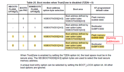

Hi @Deblina
Just to understand correctly the issue, NSBOOTADD0 and NSBOOTADD1 contains messed up addresses when programming NBOOT0 and NSWBOOT0 Option Bytes. According to the the snapshot below, which of the 2 highlighted lines correspond to your chip configuration ?
