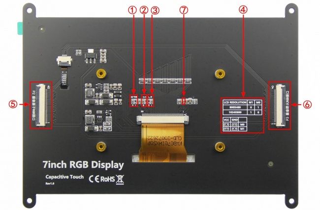

Which connector on the panel is supposed to be used for the ART-PI cable?

The panel has two connectors, atomic / wildfire, which one is used for the ART-PI ??
http://www.lcdwiki.com/7.0inch_RGB_Display
