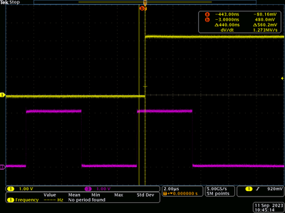

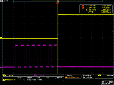

my current workadound is to use EOT as a trigger to release the SS and restrict the minimum speed that can be used on SPI.
YELLOW: NSS
RED: SCLK
125kbit/s (NSS is released too early):
1Mbit/s (NSS is released correctly):

2023-10-04 10:25 PM
YELLOW: NSS
RED: SCLK
