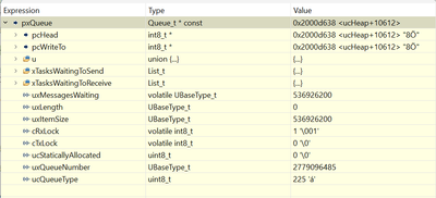

Thank you both for your replies. I try to test both, not sure if I do it correctly ;-).
@David Littell : "I'd suggest looking at what's in memory prior to pxQueue for clues". Does this help somehow:
Stack size for the taks is, if I'm correct 256 (words).
Cheers
2023-12-14 7:27 AM
It does look like the queue structure in memory is being stomped by something. As a quick test you could try 4x all the stacks. You can also convert the uxMessagesWaiting value to hex and see if that's a memory address you can examine.
Issues like this force you to dig around and work to really understand what's being allocated versus statically defined in memory - simple IDE debugger snippets aren't usually enough.
