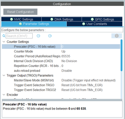

I have configured Timer1 with a frequency of 24 MHz, using channels 1 and 2 in quadrature mode to read the encoder signals. However, I am struggling to understand the relation between the timer frequency configuration and the values provided by the encoder.
Additionally, I am uncertain about how to correctly set the timer period for the encoder. Currently, I have set it equal to the timer period, but I am not sure if this is the correct approach.

You set the timer to quadrature encoder mode, okay. Then, there is no fixed frequency. The timer will count the encoder steps, up and down, depending on the direction. So, you may set the timer period to the number of encoder steps per rotation. Then, the timer counter register gives you the relative encoder position at any time.

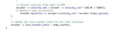

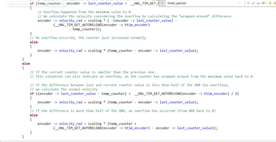

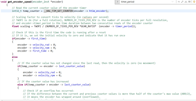

thank you for your help,
but i use this function to calculate the velocity and position and i think there is no need here to use another timer, what do you think about that ?
There is none, because a timer in encoder mode has no other fixed timer frequency configuration, but uses the (variable freq) encoder ticks.
For speed calculation, one needs some element of time, but this cannot be the timer used in encoder mode.
