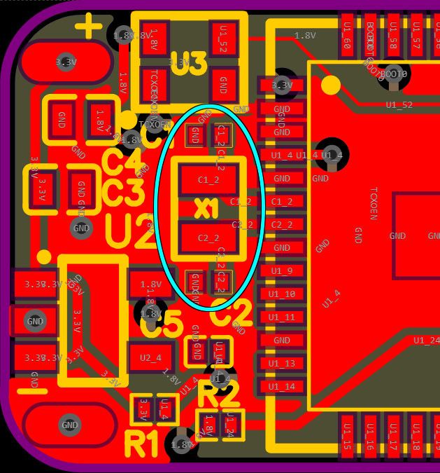

I designed my own PCB - Micro Cat Tracker (26.5 x 12 x 1.5 mm; 1 x 1/2 x 1/16 inches) sewn into cat collar. See attached picture.

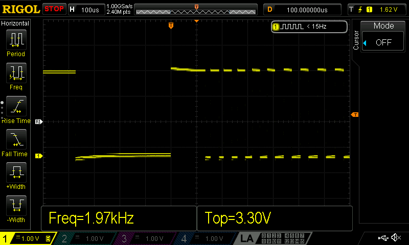

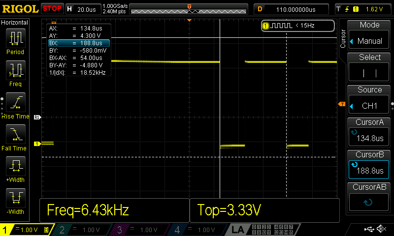

I created test program in STM32CubeIDE, just to enable LSE on MCO PA8 pin and found out the LSE is not running (as I assumed). When I touch crystal by a finger I get random oscillations I catched on attached oscilloscope screenshots.
I don't like to rebuild PSB so I will try to replace the crystal with two CL capacitors by MEMS oscillator and will check the output again.

Maybe the PCB design (4 layers) is responsible for not working LSE. I didn't expect any problems with 32.768 kHz. U3 is TCVCXO oscillator 26 MHz running well (Vpp = 1V).
Crystal used TFX-03 (+/-20ppm, CL=5pF), capacitors 6 pF.
STM32L073x, probably STM32L073CZUx in SiP (System in Package) S76G chip.
