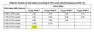

Hello @GG.2, @Tesla DeLorean,
Thank you for bringing this question to my attention!
>>This means that prefetch might be enabled even when there are 0 wait states to access flash memory
This case is not applicable in U5 Flash examples, in fact, all the examples run at 160MHz, according to this frequency, there are 4 wait states (Check RM) :
So prefetch has to be enabled, and PRFTEN must be set since there is more than 1 wait state needed.
I hope this is much more clear.

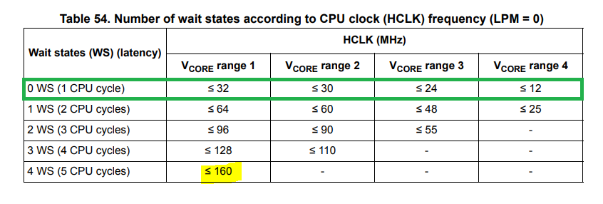

2023-10-16 4:30 AM
The problem is that I'm running my own code, not the examples, and the HAL should not assume the HCLK frequency... In my case I run at 12MHZ range 4 with 0 WS
