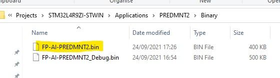

I programmed the kit using binary precompiled files as on image below.

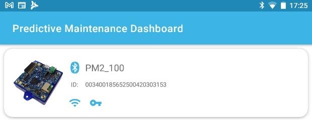

0693W00000GZpqHQAT.jpgThen, I have configured my kit using ST BLE Sensor (as reported on qs guide above)

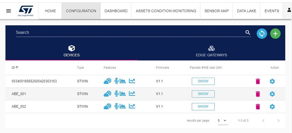

0693W00000GZpqbQAD.jpgThe kit connects to backend (see WireShark log) and on backend side, this is what I see:
