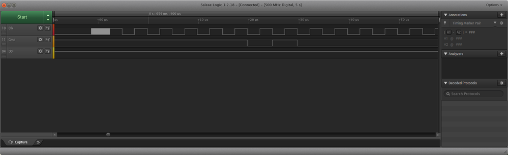

We're successfully using the eMMC connected to the SDMMC1 peripheral running on a 25MHz 8-bit bus, with ClockPowerSave ENABLED. In this configuration the eMMC will not restart because it doesn't get the required 74 clocks that are part of the initialization, and simply does not respond to the first command (there are only 4 or 5 clocks before CMD starts to toggle):

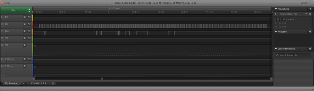

HAL_MMC_ConfigWideBusOperation(hmmc, SDMMC_BUS_WIDE_8B);On restart, the 74 clocks (or at least, most of them) come at 25MHz before HAL_MMC_Init() slows the bus down to the 200kHz initialization speed:
