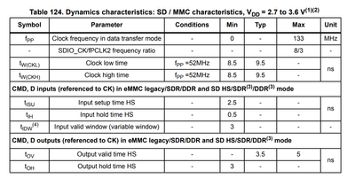

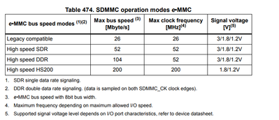

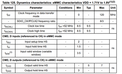

Hello @JananiRamesh and welcome to the community;
The maximum frequencies depend on e•MMC bus speed modes (SDR, DDR, HS200) and signal voltage as mentioned in reference manual and datasheet
In case of eMMC, there is no constraint on the memory size.

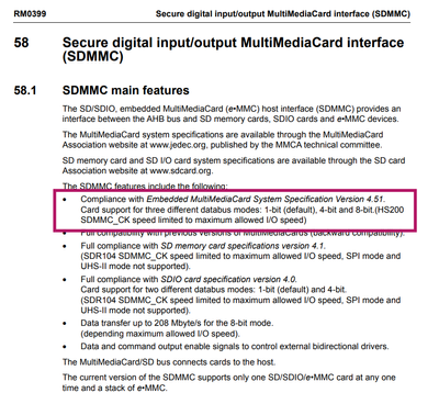

For an e•MMC, 1-bit (SDMMC_D0), 4-bit (SDMMC_D[3:0]) or 8-bit (SDMMC_D[7:0]) data bus widths can be used.
It is recommended to select an eMMC that complies with the Embedded MultiMediaCard System Specification Version 4.51.
