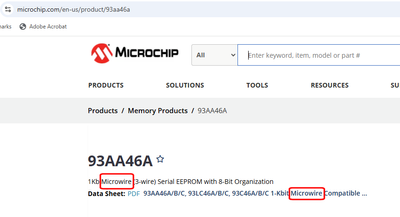

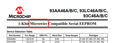

2025-02-24 1:18 AM
@Siva21 wrote:I have implemented bit-banging for SPI (sic)
But @bmckenney's point was that it's not SPI - it's Microwire:
